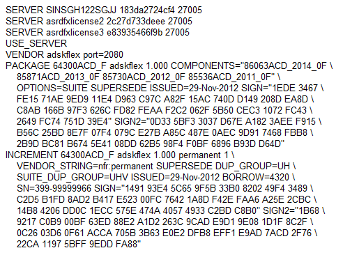

Example of a Package License File for a Redundant Server
Here is an example of a completed package license file for a redundant license server model. The distinguishing feature of this type of license file is the series of three SERVER lines at the beginning. A copy of this license file is placed on each of the specified servers.
