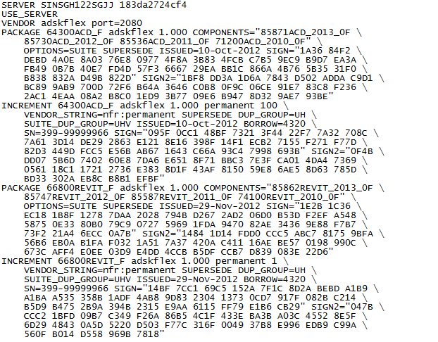

Example of a Combined Package License File
Here is an example of a package license file for multiple Autodesk product versions. The licensed products include AutoCAD 2010 to 2013, and Revit 2010 to 2013.
