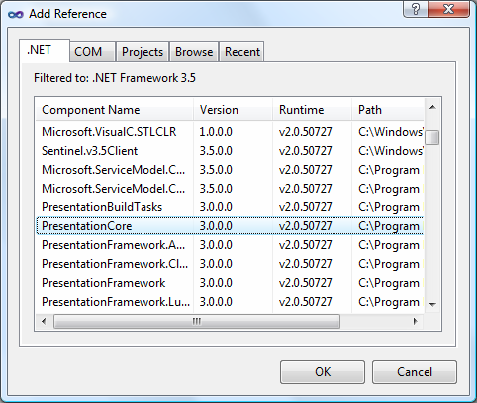

Figure 8: Add Reference

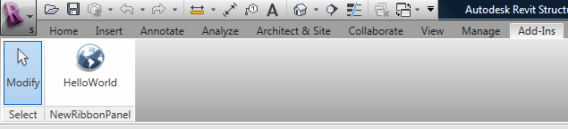

To begin debugging, build the project, and run Revit. A new ribbon panel appears on the Add-Ins tab named NewRibbonPanel and Hello World appears as the only button on the panel, with a large globe image.
Figure 9: Add a new ribbon panel to Revit

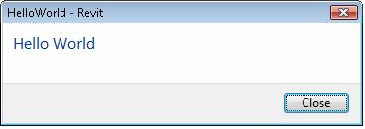

Click Hello World to run the application and display the following dialog box.
Figure 10: Hello World dialog box
