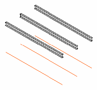

BeamSystem provides full access and edit ability to beam systems in Revit Structure. You can get and set all of its properties, such as BeamSystemType, BeamType, Direction, and Level. BeamSystem.Direction is not limited to one line of edges. It can be set to any XYZ coordinate on the same plane with the BeamSystem.
Figure 156: Change BeamSystem elevation
