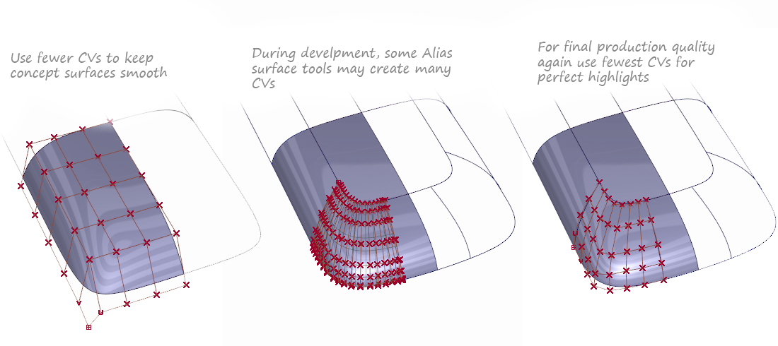

When creating curves and surfaces in Alias, we always try to aim to use as few CVs as possible. The main reasons for this are:
There are two situations when applying the rule will give you the most benefit:

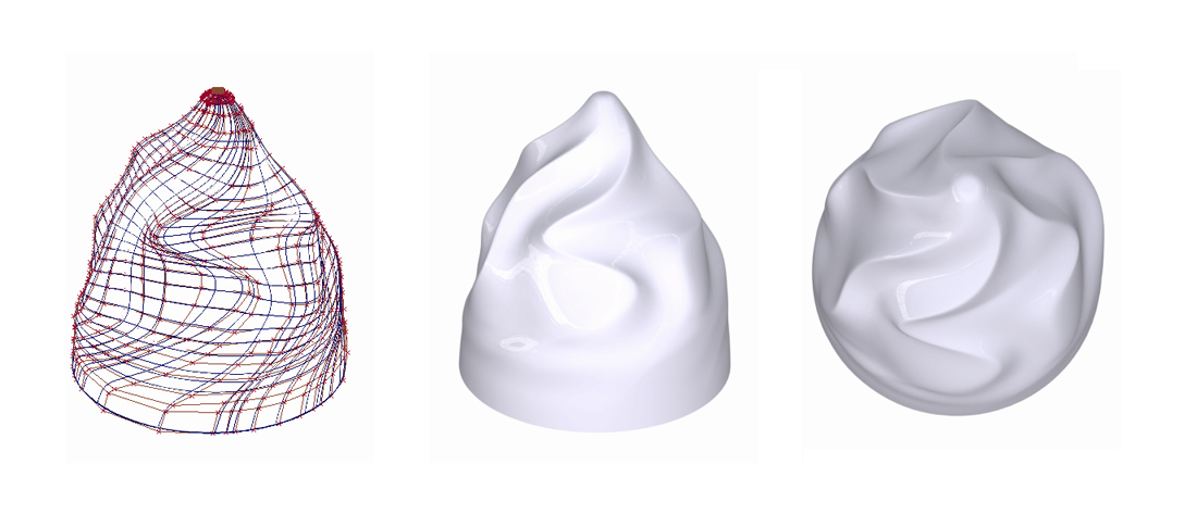

If you want to build a large area of your model from a single surface, then you may need many CVs to be able to create surface detail.
This is a powerful, quick modeling technique, made possible by using multi-span curves and surfaces. To use it well, you will need to have good control over the CV positioning – a skill you will need to practice.
For designs like this plastic food packaging cap, it achieves a result that would be almost impossible with separate surface patches, and as it is a low-cost product, then the fact that the surface isn't taut or perfectly smooth isn't a problem.

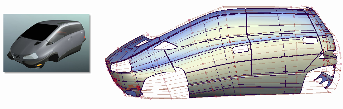

It is possible to apply this approach to concept modeling for vehicle design, but it requires a lot of skill manipulating the CVs and is an unusual approach. Also you need to recognize that the surfaces won't be smooth enough or controlled enough for production.
This example uses a single, multi-span surface to create the whole exterior design:

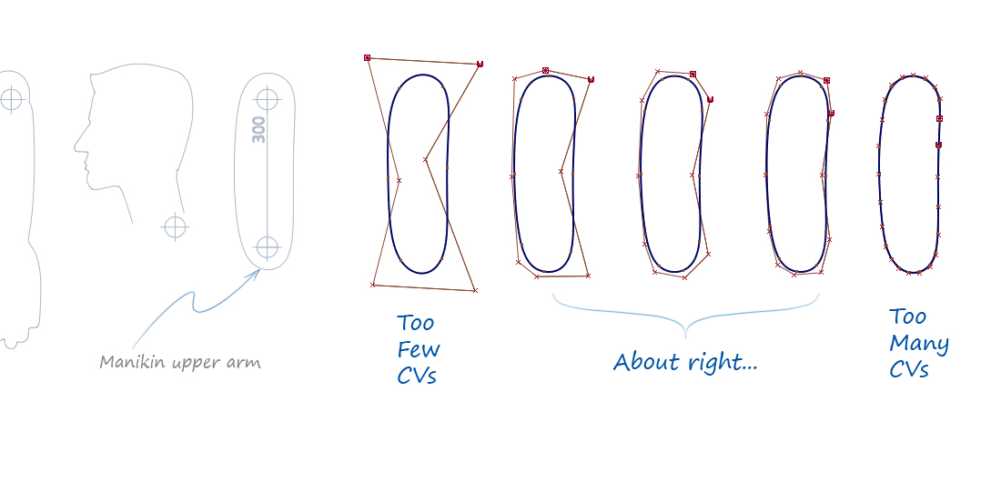

Each CV should 'have a job to do' – each CV should be instrumental in bending and shaping the curve.

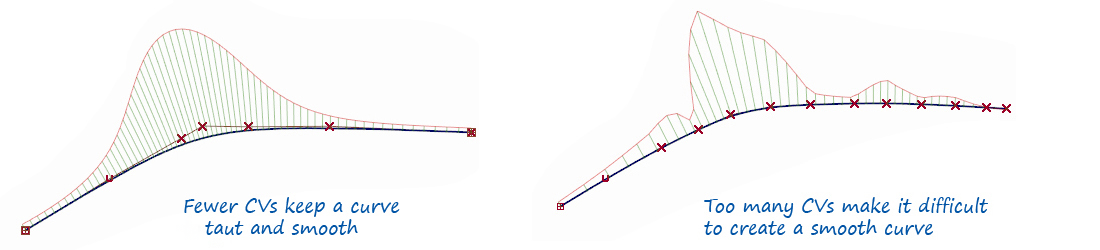

Too many: If the CVs just seem to be maintaining the shape rather than influencing it – you may have too many CVs. Another indication is when you move one CV, and then have to compensate by moving the CVs around it to maintain the shape you want.
Too few: If you have to pull your CVs into extreme positions to achieve your shape, then it is usually better to allow one or two extra CVs to achieve the shape without too much strain.
