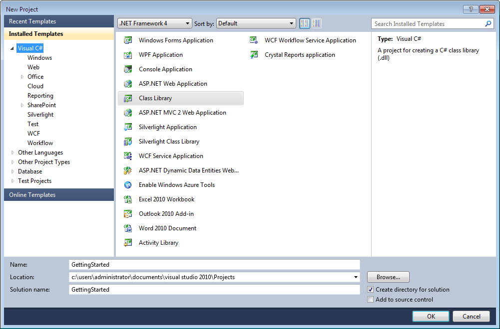

  1. In Visual Studio 2010, create a new class library solution and project.
    New Project Dialog in Visual Studio

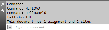

    Open or create a document in AutoCAD Civil 3D that contains alignments and sites. When you run the HELLOWORLD command now, you should see output similar to this:
