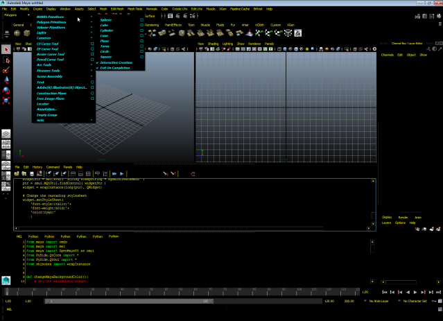

This script demonstrates how to edit the style sheet to change the Maya background color:
def changeMayaBackgroundColor(background='black', color='yellow'):
widget.setStyleSheet(
'background-color:%s;'%background +
'color:%s;'%color
)This script also demonstrates how to get a Maya control (in this case, the Create menu) as a PySide widget by first evaluating a MEL string in Python, and then using maya.OpenMayaUI.MQtUtil.findControl().
widgetStr = mel.eval( 'string $tempString = $gMainCreateMenu' ) ptr = omui.MQtUtil.findControl( widgetStr ) widget = wrapInstance(long(ptr), QWidget)
You can change the font style and weight for your menus (in this case, the Create menu) by editing the Qt stylesheet as follows:
def changeMayaMenuColors(fontStyle='italic', fontWeight='bold', fontColor='cyan'):
'font-style:%s;'%fontStyle +
'font-weight:%s;'%fontWeight +
'color:%s;'%fontColor

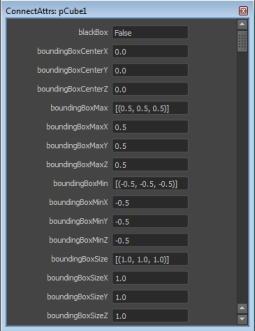

The connectAttr.py script demonstrates how to create a basic Attribute Editor that updates the attribute values, and is updated when attributes change. This way, the attribute values and control values stay in sync.
It uses mayaMixin for its dockable functions, as well as QFormLayout and QScrollLayout to create the Qt UI.
Import the mayaMixin module as follows:
from maya.app.general.mayaMixin import MayaQWidgetBaseMixin, MayaQWidgetDockableMixin
This example derives from the MayaQWidgetDockableMixin and QScrollArea classes to create the container widget and the attribute widgets:
class Example_connectAttr(MayaQWidgetDockableMixin, QScrollArea):
def __init__(self, node=None, *args, **kwargs):
super(Example_connectAttr, self).__init__(*args, **kwargs)
# Member Variables
self.nodeName = node # Node name for the UI
self.attrUI = None # Container widget for the attr UI widgets
self.attrWidgets = {} # Dict key=attrName, value=widget
.....It then uses the MayaQWidgetDockableMixin class show() method to show the widget and set the window as dockable and floating.
ui = Example_connectAttr(node=obj) ui.show(dockable=True, floating=True)
It then uses QFormLayout to create a 2-column form widget, with an attribute name string and an attribute widget.
def attachToNode(self, nodeName):
'''Connect UI to the specified node
self.nodeName = nodeName
self.attrs = None
self.nodeCallbacks = []
self._deferredUpdateRequest.clear()
self.attrWidgets.clear()
# Get a sorted list of the attributes
attrs = cmds.listAttr(self.nodeName)
attrs.sort() # in-place sort the attributes
# Create container for attribute widgets
self.setWindowTitle('ConnectAttrs: %s'%self.nodeName)
self.attrUI = QWidget(parent=self)
layout = QFormLayout()
# Loop over the attributes and construct widgets
acceptedAttrTypes = set(['doubleLinear', 'string', 'double', 'float', 'long', 'short', 'bool', 'time', 'doubleAngle', 'byte', 'enum'])
for attr in attrs:
# Get the attr value (and skip if invalid)
try:
attrType = cmds.getAttr('%s.%s'%(self.nodeName, attr), type=True)
if attrType not in acceptedAttrTypes:
continue # skip attr
v = cmds.getAttr('%s.%s'%(self.nodeName, attr))
except Exception, e:
# Create the widget and bind the function
attrValueWidget = QLineEdit(parent=self.attrUI)
attrValueWidget.setText(str(v))
# Add to layout
layout.addRow(attr, attrValueWidget)
# Track the widget associated with a particular attribute
self.attrWidgets[attr] = attrValueWidget
# Attach the QFormLayout to the root attrUI widget
self.attrUI.setLayout(layout)It uses functools.partial() to add metadata to setAttr, then connect to the attrValueWidget.editingFinished signal:

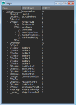

The widgetHierarchy.py script demonstrates how to create a Qt widget that lists all the Qt widgets used in Maya.
The tree list is created by deriving from MayaQWidgetBaseMixin and QTreeView:
class WidgetHierarchyTree(MayaQWidgetBaseMixin, QTreeView):
def __init__(self, rootWidget=None, *args, **kwargs):
super(WidgetHierarchyTree, self).__init__(*args, **kwargs)This example demonstrates how to delete a widget when it is closed:
self.setAttribute(Qt.WA_DeleteOnClose, True)
It sets up for populating the hierarchy tree by setting the root widget:
# Determine root widget to scan
if rootWidget != None:
self.rootWidget = rootWidget
else:
mayaMainWindowPtr = omui.MQtUtil.mainWindow()
self.rootWidget = wrapInstance(long(mayaMainWindowPtr), QWidget)To populate the tree view, the example calls QStandardItem for each column and recurses through the child widgets:
def populateModel(self):
# Create the headers
self.columnHeaders = ['Class', 'ObjectName', 'Children']
myModel = QStandardItemModel(0,len(self.columnHeaders))
for col,colName in enumerate(self.columnHeaders):
myModel.setHeaderData(col, Qt.Horizontal, colName)
# Recurse through child widgets
parentItem = myModel.invisibleRootItem();
self.populateModel_recurseChildren(parentItem, self.rootWidget)
self.setModel( myModel )
def populateModel_recurseChildren(self, parentItem, widget):
# Construct the item data and append the row
classNameStr = str(widget.__class__).split("'")[1]
classNameStr = classNameStr.replace('PySide.','').replace('QtGui.', '').replace('QtCore.', '')
items = [QStandardItem(classNameStr),
QStandardItem(widget.objectName()),
QStandardItem(str(len(widget.children()))),
parentItem.appendRow(items)
# Recurse children and perform the same action
for childWidget in widget.children():
self.populateModel_recurseChildren(items[0], childWidget)
The defaultWidget.py script sets up the framework for creating a default widget (a push button created using QPushButton) and a derived widget. You can use this framework to create the default widget, or your own override widget.
