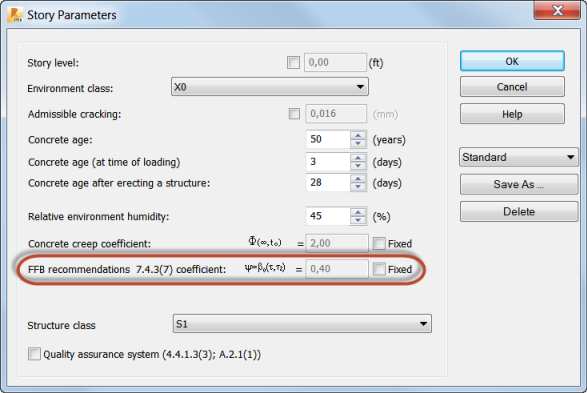

New set of beam deflections according to FFB recommendations
A new set of deflection options has been added to the calculation options for beams, according to the FFB recommendations from the NF EN 1992-1-1/NA:2007 code.
These new options are in accordance with the NF EN 1992-1-1/NA:2007 codes.

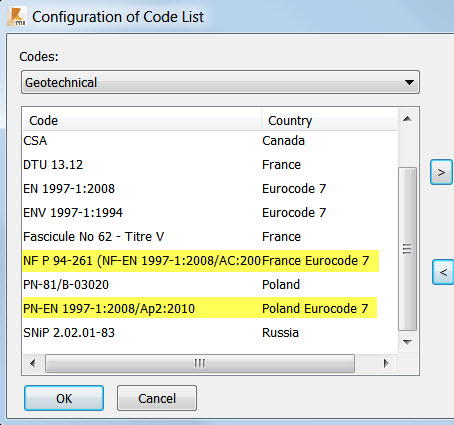

New geotechnical codes
The following geotechnical codes have been added:
  • Polish: PN-EN 1997 -1:2008/Ap2:2010.
  • French: NF P 94-261 (NF-EN 1997-1:2008/AC:2009).
To find these new codes:
  1. Click Tools Job Preferences Design codes.
  2. Open the list of Geotechnical codes, and then click More.
    The list of geotechnical codes displays.
