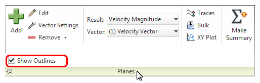

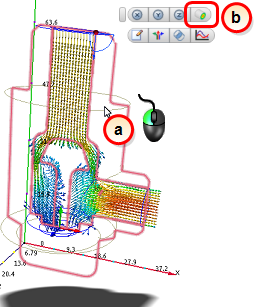

1. The next steps are easier if we resume the plane outline. Click the drop down menu on the Planes context panel, and check Show Outlines:
2. We can create traces on a plane located anywhere, but the inlet is often the most convenient place. To align the plane to the inlet:
You should see this:

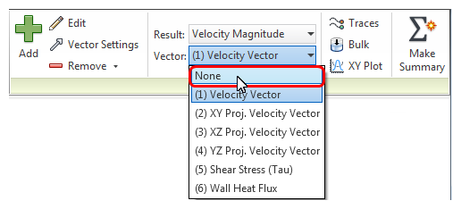

3. To improve visibility, we should disable the vectors. Select None from the Vector menu in the Planes context panel:

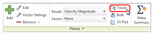

4. To create traces, click Traces:

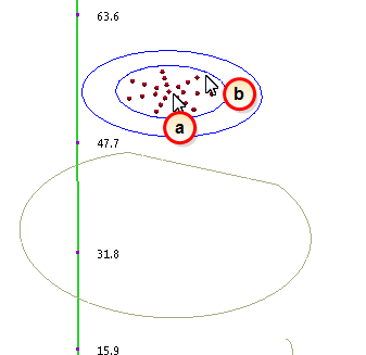

6. Enter 7 in the Circular menu, and click Add points.
7. To create the trace seed grid:

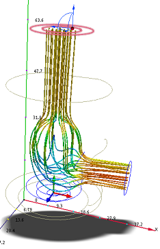

8. Click Add trace set to finish:
Note: This is an interesting view, but it would be better to see how the traces interact with the solid parts.

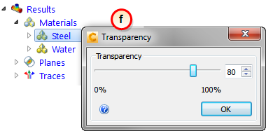

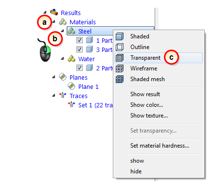

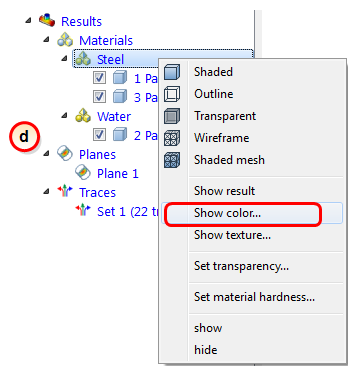

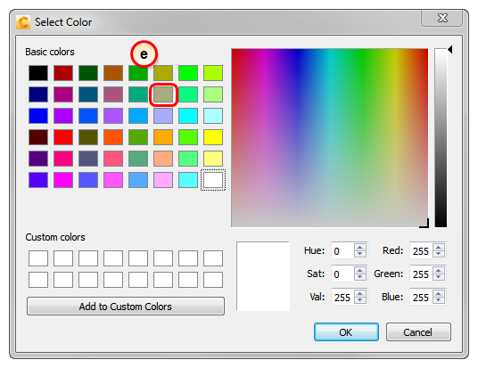

9. To display the pipe and poppet transparently:
That's better! This helps us understand how the flow moves through the valve. The traces are colored by velocity magnitude, so we can also see how the flow accelerates as the water enters the outlet pipe.
