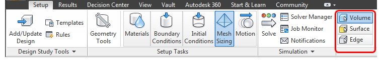

Set the Selection Mode
There are times when you will need to change the type of object that can be selected:
From the Setup tab:

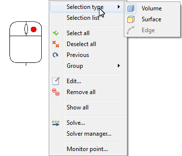

From the right click mouse menu:
From the Quick Access toolbar...

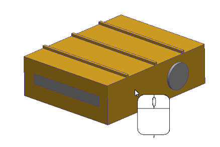

Selection Coloring
Autodesk® CFD uses color coding to help with the selection process…
When you hover over a part or surface in the Setup tasks, it turns green:
Select the object by left clicking on it. It turns red:
If you hover over a selected object, it turns yellow:
To deselect an object, left click on it.

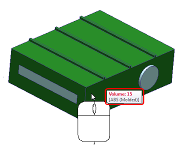

In many cases, it is helpful to hide a part or surface to access an internal component.
To hide an object: Hover over it, and press Ctrl and the middle mouse button:
Note: You can also hide an object by right clicking on it, and selecting Hide from the menu.
To select an object and then hide it, left click on it, and click Hide from the context toolbar: . Note that the part is selected because you left clicked on it. This is useful when you want to assign the same setting to external and internal parts:
To show all parts: Press Ctrl and middle click off the model in the graphics window.

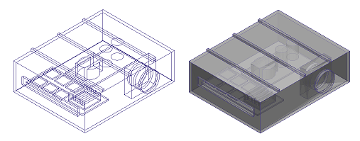

Model Appearance
By default, the model appears shaded, like this:
To show the model as an outline or as transparent, select from the Visual Style menu in the Quick Access toolbar:
Alternatively, select from View (tab) > Visual Style.

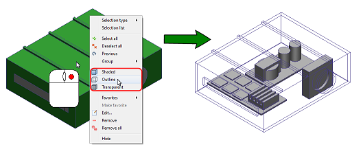

To change the appearance of an individual part, right click on it, and select from the menu:

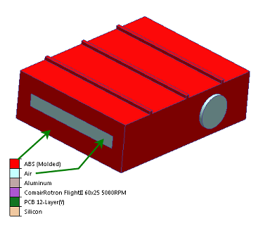

The Design Study Bar shows all assigned settings under the appropriate branch:
Graphical cues and a corresponding legend show where settings are applied:
Tooltips show the values of applied settings. Hover your mouse over the part or surface to view the tooltip:
