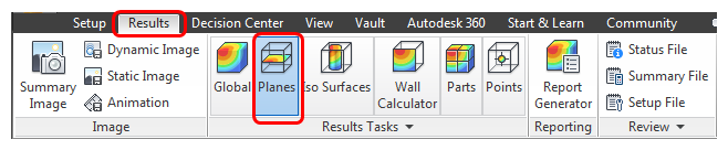

To do this, we'll use some powerful visualization tools: results planes and iso surfaces. With these we can visualize the flow inside the office.
1. To start, click Results (tab) > Results Tasks (panel) > Planes.

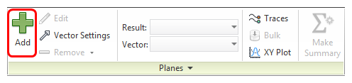

2. To create a plane, click Add on the Planes context panel.
You should see this:

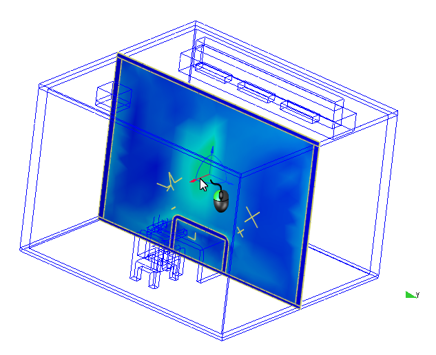

3. We need to see the flow around the occupant. To move the plane, left click on the axis in the middle of the plane, and drag it toward the occupant.

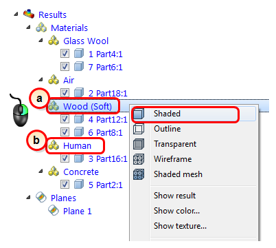

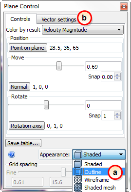

4. To improve the view, we should shade the occupant and furniture:

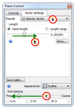

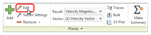

5. The colors are nice, but we need vectors to really understand the flow! To show vectors, click Results (tab) > Results Tasks (panel) > Planes, and click Edit from the Planes context menu:
On the Plane Control dialog, do the following:
On the Vector settings tab, do the following:
