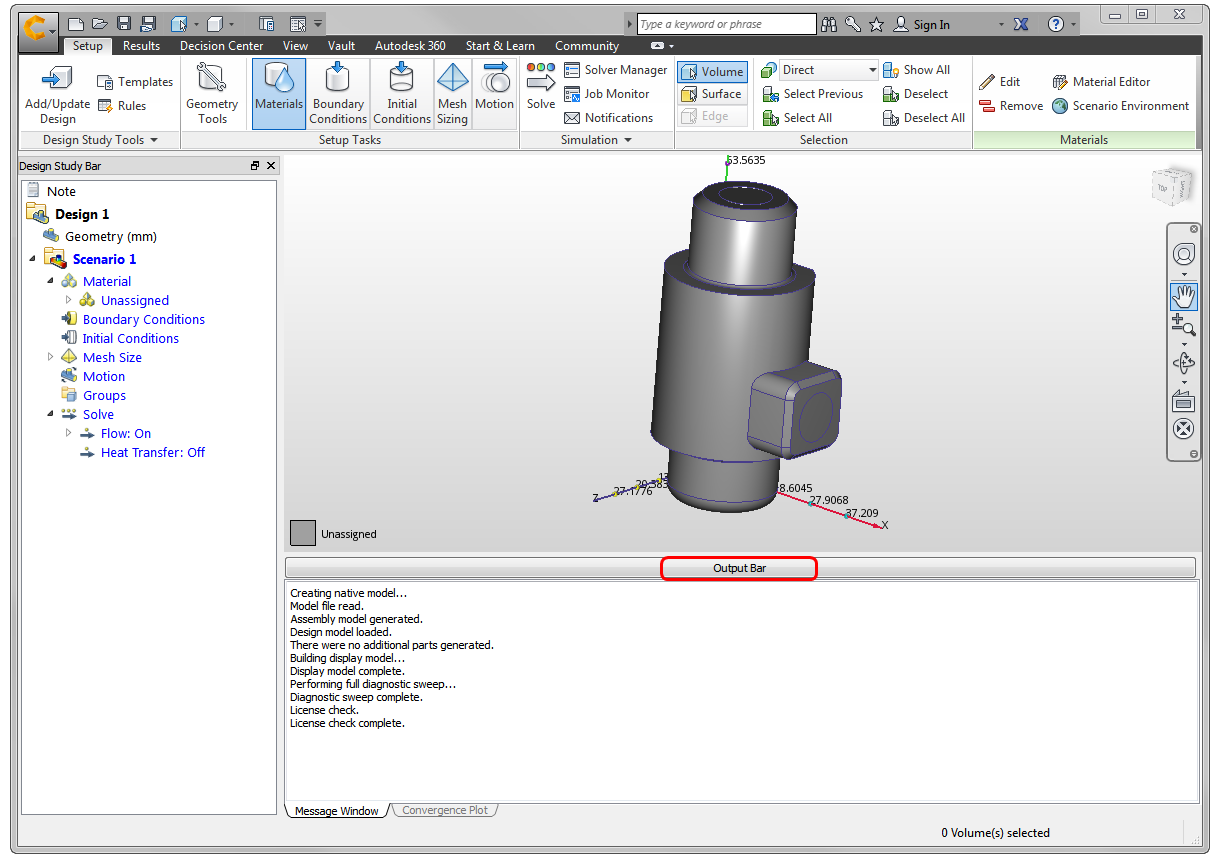

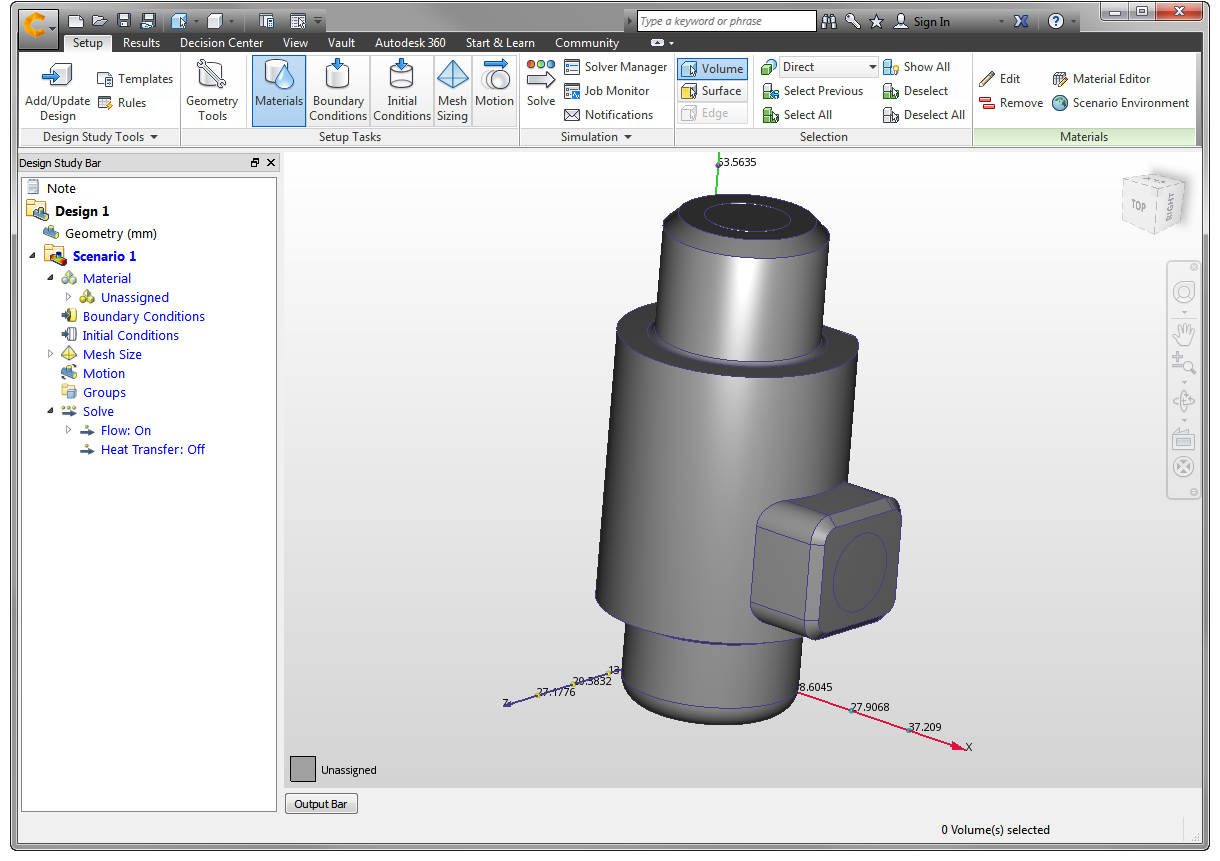

1. To open up some additional screen space, collapse the Output bar by clicking the Output Bar button:

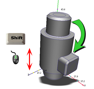

2. To rotate the model, press Shift and the middle mouse button, and move the mouse:

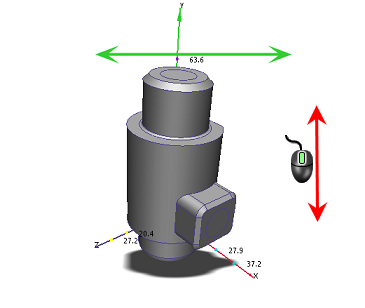

4. To pan (move), hold the middle mouse button, and move the mouse:

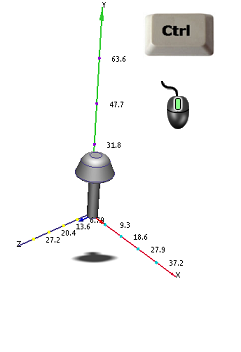

5. To hide an object, hover over it, and press Ctrl and the middle mouse button:

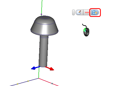

An alternative way to hide parts is to left click, and click the Hide icon from the toolbar:
