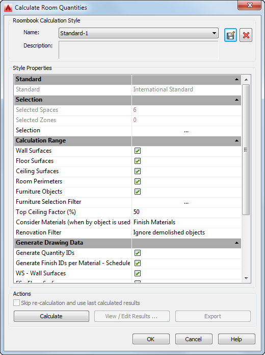

The room quantity calculation requires to specify the range of calculation, based on the current calculation standard. You can store different calculation styles with different settings in the drawing. Make sure that the right calculation standard is set current in calculation settings.
- Click
- Select a style name from the list.
- Specify the Selection of Spaces and Zones.
- Specify the Calculation Range (quantities per space):
- Surfaces of walls, floors, and ceilings
- Room perimeter and furniture objects.
- Specify the Selection of Furniture Styles.
- Specify the Generation Drawing Data.
- Click Calculate.
- Style Name
- Under Roombook Calculation Styles, you can save different Roombook calculations. This allows to define and store different calculations in the drawing. Default is style "Standard". By saving under a different name, you can define different calculations (different spaces, zones, calculation ranges etc.) which are stored in the drawing. Enter a description of needed.
- Save
- Save, copies, or renames the current style.
- Delete
- Deletes the current style from the drawing. One style however must always remain in the drawing.
- Style Properties
- All settings which are made in this dialog box (selection, range, export), are stored in the current room quantity calculation style name. The Calculation Settings however, are not stored in the style, but globally in the drawing. If needed, you have to change them prior to a new calculation.
- Calculation Standard
- Displays the current calculation standard information. This information can be changed in the Calculation Settings dialog box only.
- Selection of Spaces and Zones
- Displays the number of spaces and zones which are selected for calculation in the current style name. Click Selection "..." button for the Selection of Spaces and Zones.
- Calculation Range
- Roombook calculates the quantities on a per space basis. Minimum requirement is at least one space enclosed by walls. Theoretically it is also possible that the room is defined only by space bounding lines; in this case the space bounding lines are considered as wall surfaces (without area, height).
