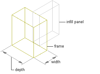

You can define a frame by specifying its width and depth. The overall frame size is determined by the length and height of the curtain wall unit grid.
Specifying frame width and depth
