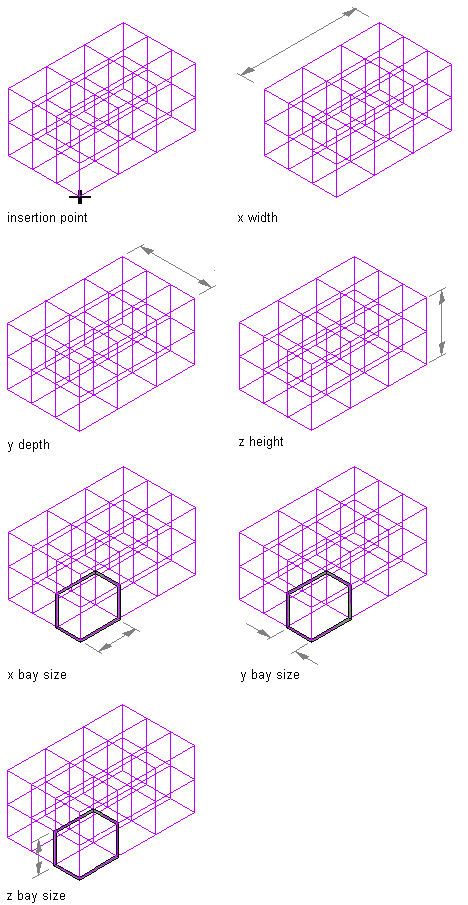

- On the Properties palette, expand Basic, and expand General.
- Enter a value for the X width, Y depth and the Z height.
- Select the Repeat option for Layout type, and enter values, for X Axis, Y Axis, and Z Axis bay size and start and end offsets.
- Specify an insertion point in the drawing for the lower-left corner of the rectangular layout grid.
- Specify the rotation of the rectangular grid about the insertion point.
