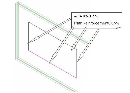

While the AreaReinforcement.GetBoundaryCurveIds() method returns a set of ElementIds representing AreaReinforcementCurves, which have a property that returns a Curve, the PathReinforcement.GetCurveElementIds() method returns a collection of ElementIds that represent ModelCurves. There is no way to flip the PathReinforcement except by on creation using the PathReinforcement.Create() method. PathReinforcment can only be created using an array of curves.
Figure 155: PathReinforcement ModelCurves in edit mode
Code Region 29-4: Creating path reinforcement |
