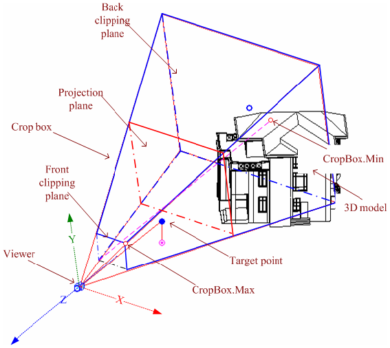

The following picture illustrates how a perspective view is created.
Figure 96: Perspective projection
  • The straight projection rays pass through each point in the model and intersect the projection plane to form the projection contents.

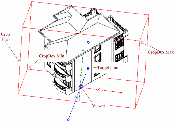

  • To facilitate the transformation from the world coordinate onto the view plane, the viewing coordinate system is based on the viewer.
  • Its origin, represented by the View.Origin property, is the viewer position.
  • The viewer's world coordinates are retrieved using the ViewOrientation3D.EyePosition property (retrieved from View3D.GetOrientation()). Therefore, in 3D views, View.Origin is always equal to the corresponding ViewOrientation3D.EyePosition.
  • As described in the diagram above, the viewing coordinate system is determined as follows:
    • The X-axis is determined by View.RightDirection.
    • The Y-axis is determined by View.UpDirection.
    • The Z-axis is determined by View.ViewDirection.
  • The view direction is from the target point to the viewer in the 3D space, and from the screen to the viewer in the screen space.

The perspective view crop box is part of a pyramid with the apex at the viewer position. It is the geometry between the two parallel clip planes. The crop box bounds the portion of the model that is clipped out and projected onto the view plane.
  • The crop box is represented by the View.CropBox property, which returns a BoundingBoxXYZ object.
  • The CropBox.Min and CropBox.Max points are marked in the previous picture. Note that the CropBox.Min point in a perspective view is generated by projecting the crop box front clip plane onto the back clip plane.
Crop box coordinates are based on the viewing coordinate system. Use Transform.OfPoint() to transform CropBox.Min and CropBox.Max to the world coordinate system. For more detail about Transform, refer to Geometry.Transform in the Geometry section.
The project plane plus the front and back clip plane are all plumb to the view direction. The line between CropBox.Max and CropBox.Min is parallel to the view direction. With these factors, the crop box geometry can be calculated.

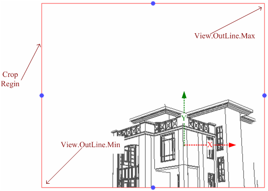

The previous picture shows the projection plane on screen after cropping. The crop region is the rectangle intersection of the projection plane and crop box.
  • Geometry information is retrieved using the View.CropRegion property. This property returns a BoundingBoxUV instance.
  • The View.OutLine.Max property points to the upper right corner.
  • The View.OutLine.Min property points to the lower left corner.
  • Like the crop box, the crop region coordinates are based on the viewing coordinate system. The following expressions are equal.
View.CropBox.Max.X(Y) / View.OutLine.Max.X(Y) == View.CropBox.Min.X(Y) / View.OutLine.Min.X(Y)

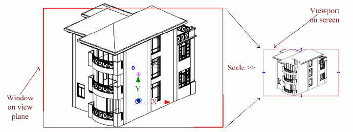

Isometric views are generated using parallel projection rays by projecting the model onto a plane that is normal to the rays. The viewing coordinate system is similar to the perspective view, but the crop box is a parallelepiped with faces that are parallel or normal to the projection rays. The View.CropBox property points to two diagonal corners whose coordinates are based on the viewing coordinate system.
Figure 99: Scale the window on view plane to screen viewport
The model is projected onto a view plane and then scaled onto the screen. The View.Scale property represents the ratio of actual model size to the view size. The related expressions are as follows:
View.CropBox.Max.X(Y) / View.OutLine.Max.X(Y) == View.CropBox.Min.X(Y) / View.OutLine.Min.X(Y) == View.Scale

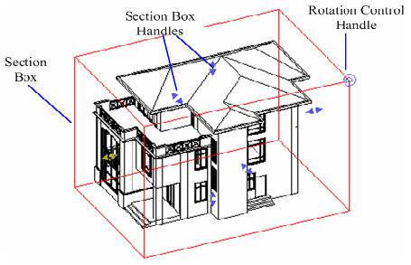

3D Views SectionBox
Each view has a crop box. The crop box focuses on a portion of the model to project and show in the view. For 3D views, there is another box named section box.
  • The section box determines which model portion appears in a 3D view.
  • The section box is used to clip the 3D model's visible portion.
  • The part outside the box is invisible even if it is in the crop box.
  • The section box is different from the crop box in that it can be rotated and moved with the model.
The section box is particularly useful for large models. For example, if you want to render a large building, use a section box. The section box limits the model portion used for calculation. To display the section box, in the 3D view Element Properties dialog box, select Section Box in the Extents section. You can also set it using the IsSectionBoxActive property. In the example below, if the active view is a 3D view, it sets whether the section box is active.

Figure 100: Section box
The View3D.GetSectionBox() and View3D.SetSectionBox() methods are used to get and change the box extents. In some cases, calling View3D.SetSectionBox() can have a side effect. Setting the property to certain values can change the box capacity and display it in the view. To avoid displaying the section box, set the IsSectionBoxActive property to false.

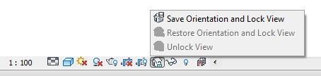

View Locking
The View3D class has methods and properties corresponding to the locking feature available in the Revit user interface.
The View3D.SaveOrientationAndLock() method will save the orientation and lock the view while View3D.RestoreOrientationAndLock() will restore the view's orientation and lock it. View3D.Unlock() will unlock the view if it is currently locked. The IsLocked property will return whether the 3D view is currently locked.
