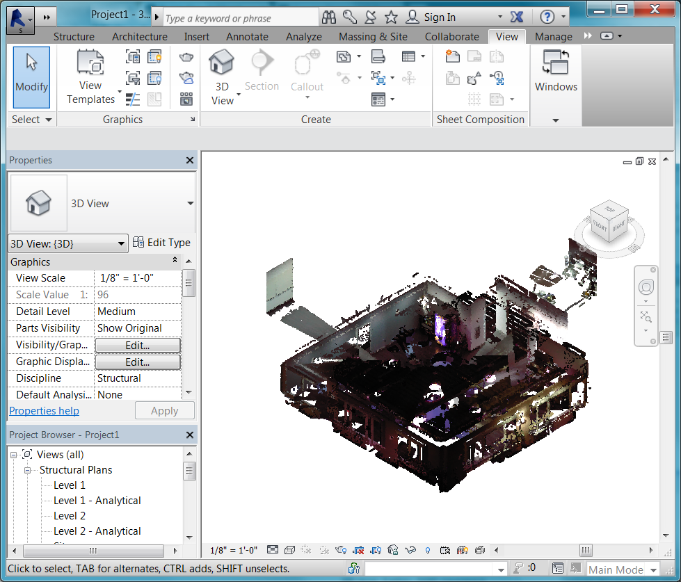

To create a new point cloud in a Revit document, create a PointCloudType and then use it to create a PointCloudInstance. The static PointCloudType.Create() method requires the engine identifier, as it was registered with Revit by a third party, or the file extension of the point cloud file, if it is a supported file type. It also requires a file name or the identification string for a non-file based engine. In the following sample, a pcg file is used to create a point cloud in a Revit document.
Code Region: Create a point cloud from an rcsrcs file |
private PointCloudInstance CreatePointCloud(Document doc)
PointCloudType type = PointCloudType.Create(doc, "rcs", "c:\\32_cafeteria.rcs");
return (PointCloudInstance.Create(doc, type.Id, Transform.Identity));
Figure: Point Cloud from 32_cafeteria.rcs

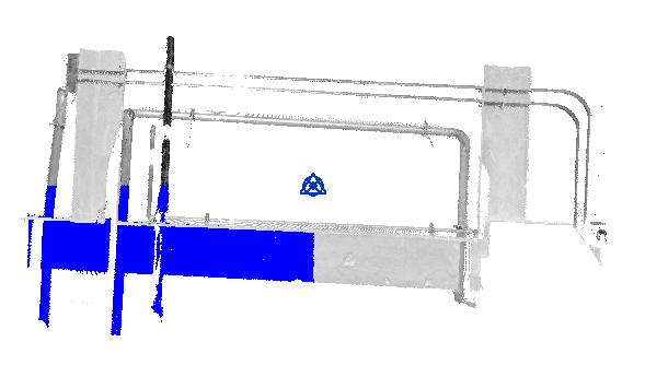

The following example will highlight a subset of the points in a point cloud based on its bounding box.
Code Region: Reading point cloud points by pointer |
// Filter will match 1/8 of the overall point cloud // Use the bounding box (filter coordinates are in the coordinates of the model) BoundingBoxXYZ boundingBox = pointCloudInstance.get_BoundingBox(null); List<Plane> planes = new List<Plane>(); XYZ midpoint = (boundingBox.Min + boundingBox.Max) / 2.0; // X boundaries planes.Add(app.Create.NewPlane(XYZ.BasisX, boundingBox.Min)); planes.Add(app.Create.NewPlane(-XYZ.BasisX, midpoint)); // Y boundaries planes.Add(app.Create.NewPlane(XYZ.BasisY, boundingBox.Min)); planes.Add(app.Create.NewPlane(-XYZ.BasisY, midpoint)); // Z boundaries planes.Add(app.Create.NewPlane(XYZ.BasisZ, boundingBox.Min)); planes.Add(app.Create.NewPlane(-XYZ.BasisZ, midpoint)); // Create filter PointCloudFilter filter = PointCloudFilterFactory.CreateMultiPlaneFilter(planes); pointCloudInstance.FilterAction = SelectionFilterAction.Highlight; |
This is the result when the sample above is run on a small pipe point cloud:
Figure: Point cloud with selection filter
