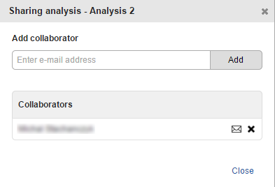

To share an analysis:
Sharing icon. It must be the e-mail address used in credentials of an already existing Autodesk account. The added collaborator displays on the list under Collaborators.

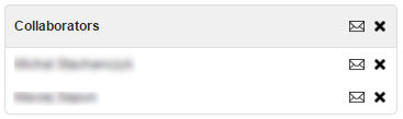

to send the collaborator an invitation e-mail containing the link to the selected analysis. On the project page, after you shared the analysis, the Share icon next to the analysis changes to
If you added several collaborators to the list, you can click
in the Collaborators row to send invitation e-mails to all of them.
To remove collaborators from the sharing list:
in the row containing the collaborator's name.
in the Collaborators row. To communicate with owners about analyses shared with you:
