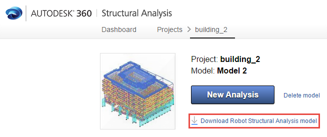

The Robot Structural Analysis engine performs analyses in the cloud. You can download an Robot Structural Analysis model with or without results from the Autodesk® 360 Structural Analysis website.
To download the structure model without results
To download the structure model with results for a selected analysis
(Download Robot Structural Analysis model) in the Analysis column.
