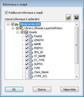

Set DWF publishing options that specify the attribute information to publish with your map.
If you are connected to the internet, play the video to see how to specify the attributes to include in a published DWF file. You can also click "Let Me Try" to try it yourself. The steps for this procedure are listed below the video. |
To set publishing options
Open
Drawing.
(MAPDWFOPTIONS).
You can include and exclude information at any level.
Notice that when you select Roads, everything under Roads is automatically selected.
The DWF Publish operation uses the XML file.
