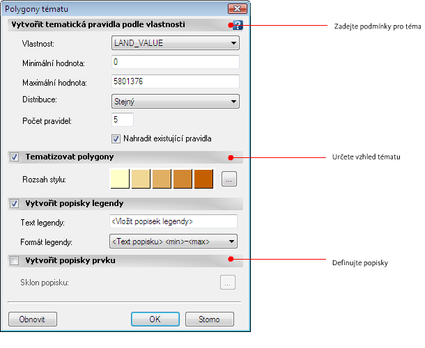

Tie the theme definition to the value of the parcels: lighter colors represent parcels with lower values and darker colors represent parcels with higher values. The parcel value is the "condition" used to determine the color of the parcel in the map.
If you are connected to the internet, play the video to define a theme. You can also click "Let Me Try" to try it yourself. The steps for this procedure are listed below the video. |
To define the theme
Leave the minimum value, maximum value, and distribution settings as they are.
Use the Theme Layer dialog box to design your theme.
