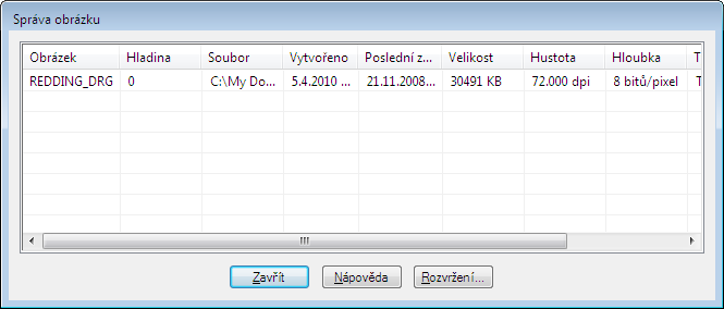

You can view the file name, size, density, depth, and type for an image you inserted. You can also view the date the image was created and modified, and the layer on which it resides.
In this exercise, you view information about the raster image in two ways. The second method displays some additional information, such as the width and height of the image.
If you are connected to the Internet, play the video to see how to view information about a raster. The steps for this procedure are listed below the video. |
To view information about a raster image
. Find
The Image Management dialog box displays information about the selected image.

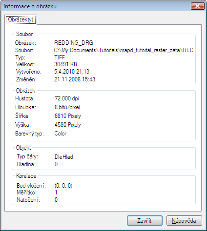

Place your cursor over the image, hold down the Shift key, and click the image.
Information.
The Image Information dialog box has some extra image information.
