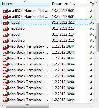

Drawing.
Select map2d.dwt
This file is an AutoCAD template that is set up to work with two-dimensional maps in AutoCAD Map 3D.
