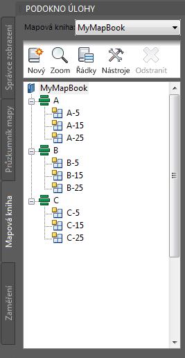

When you generate the map book, the tiles are listed in the Task Pane, and one layout tab is displayed for each tile.
Each letter represents a row of tiles, with the numbered tiles for that row indented below it
One layout tab is created for each of the map book tiles
The map tile for the layout tab appears in the main viewport.
The view changes to show the adjacent tile.
