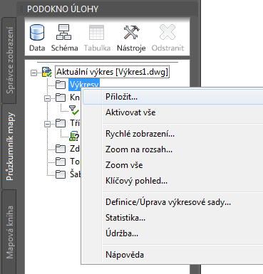

To attach drawings
Attach drawings from the Map Explorer tab of the Task pane.
The parcel, sewer, and drainage drawings are now attached to the Redding.dwg file, but no drawing objects have been added yet.
