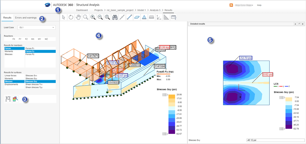

Overview
1. Navigation and Settings
It contains commands allowing you to manipulate with the model in the view, and specify display settings for the model and results. See: Model Manipulation and Settings in 3D Structure Viewer.
2. Tabs
  • Results.
    Displays a list of results depending on the type of a performed analysis: static or gravity. You can also display the same result types in Revit.
  • Errors and warnings
    Displays errors and warnings reported during the analysis in a 3D view. This tab displays for analyses which contain errors or warnings reported during calculations. Model elements causing errors or warnings are marked with Element IDs from Revit.
    See Visualize Structural Analysis Results in the 3D Structure Viewer.
3. Additional results available only on the website
You can display additional result types and explore them only on the website. You cannot download them to Revit. Types of available results depend on the analysis type. You can also display detailed results for an element selected in the view. See: Results in 3D Structure Viewer and Visualize Structural Analysis Results in the 3D Structure Viewer.
4. 3D View
This is a calculation model in a 3D view. It displays a selected result type for the model. Specify the display settings in the Settings dialog. To narrow down the value range of results, click and hold down the legend ranges, and move them to up and down.
5. Detailed results view
The Detailed results view displays after you click the Explore detailed results icon. It displays extreme values of the selected result type, maps (for surface elements), and diagrams (for members) for an element you selected in the 3D view (4). You can also display result values at points that you select.
