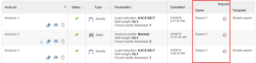

Results are available in the form of predefined analysis reports on the Autodesk® 360 Structural Analysis website. You can view them in the HTML or PDF format. You can also download and save them locally.
To view a report from the website
  1. On the Projects tab, select a project.
  2. On the project page, select a model.
  3. Locate the row that contains the analysis, and then click the report link (for an HTML format) or click the PDF icon.
