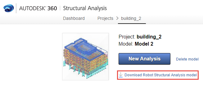

To download the structure model without results
  1. On the Projects tab, select a project.
  2. On the project page, select a model to download.
  3. Click the Download Robot Structural Analysis model link.
  4. Save the RTD file.
