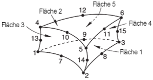

Unterstützte Kontinuumselemente
  Beschreibung Abaqus ANSYS
4-Knoten-Tetraeder
C3D4
C3D4H
SOLID45 (Tetraederoption)
SOLID164 (Tetraederoption)
SOLID185 (Tetraederoption)
MESH200 (KEYOPT(1) = 8)
SOLID285
10-Knoten-Tetraeder
C3D10
C3D10H
C3D10I
C3D10M
C3D10MH
SOLID92
SOLID95 (Tetraederoption)
SOLID168
SOLID186 (Tetraederoption)
SOLID187
MESH200 (KEYOPT(1) = 9)
SOLID226 (Tetraederoption)
SOLID227
6-Knoten-Keil/-Prisma
C3D6
C3D6H
SC6R
SOLID45 (Prismaoption)
SOLID164 (Prismaoption)
SOLID185 (Prismaoption)
SOLSH190 (Prismaoption)
15-Knoten-Keil/-Prisma
C3D15
C3D15H
C3D15V
C3D15VH
SOLID95 (Prismaoption)
SOLID186 (Prismaoption)
SOLID226 (Prismaoption)
8-Knoten-Hexaeder
C3D8
C3D8H
C3D8I
C3D8IH
C3D8R
C3D8RH
SC8R
SOLID5
SOLID45
SOLID185
SOLSH190
MESH200 (KEYOPT(1) = 10)
20-Knoten-Hexaeder
C3D20
C3D20H
C3D20R
C3D20RH
C3D27
C3D27H
C3D27R
C3D27RH
SOLID95
SOLID186
MESH200 (KEYOPT(1) = 11)
SOLID226
5-Knoten-Pyramide N/A
SOLID164 (Pyramidenoption)
SOLID185 (Pyramidenoption)
13-Knoten-Pyramide N/A
SOLID95 (Pyramidenoption)
SOLID186 (Pyramidenoption)
SOLID226 (Pyramidenoption)
