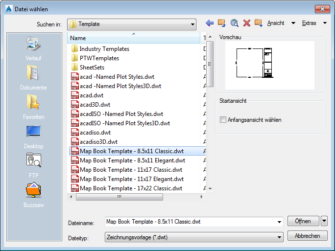

Open
Drawing. AutoCAD Map 3D automatically changes to the Template folder.
Scroll halfway down the list of templates and select the first map book template.

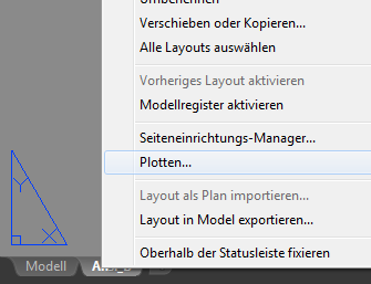

Right-click the layout tab for the map book and choose Page Setup Manager.
