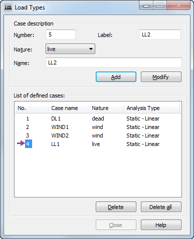

Learn how to define dead, wind and live load cases.
The layout is divided in three parts: View, Load Types dialog, and Loads Case table.
The DL1 load is added to the list of defined cases (see image in step 6), and a new row is created in the Loads - Case table.
The WIND1 load is added to the list of defined cases.
The LL1 load is added to the list of defined cases and all loads are now ready to be applied on the structure.
