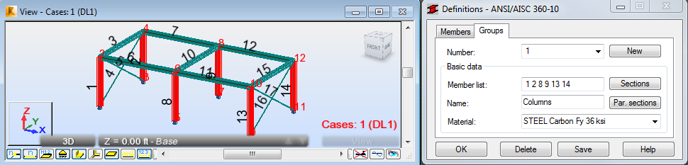

Learn how to define groups of members.
Alternatively, enter the column numbers "1 2 8 9 13 14" in the Member list box.
The defined group of columns is shown below.

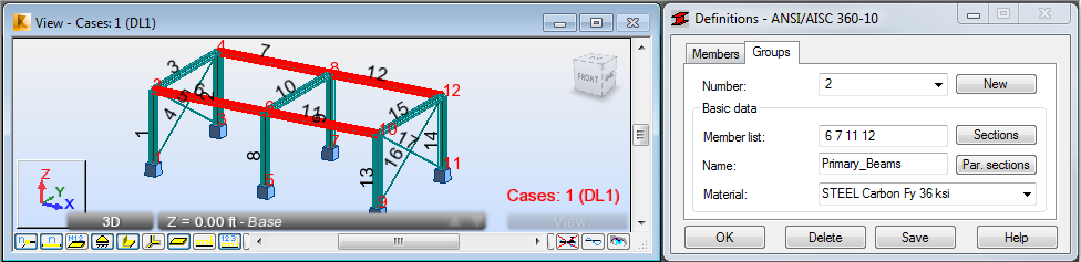

Alternatively, enter the beam numbers "6 7 11 12" in the Member list box.
The newly defined group of beams is shown below.

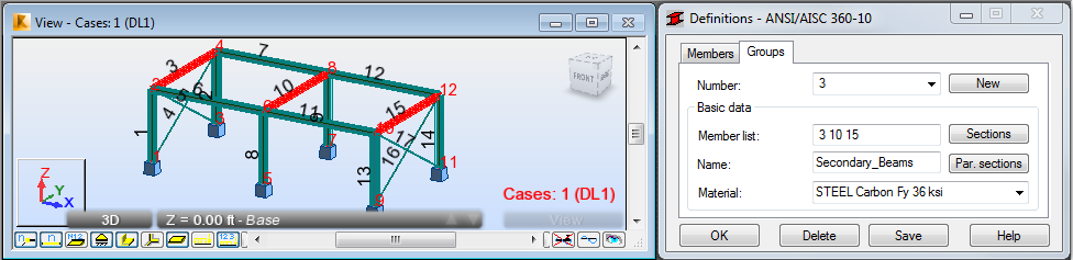

Alternatively, enter the beam numbers "3 10 15" in the Member list box.

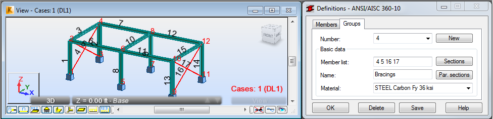

Alternatively, enter the beam numbers "4 5 16 17" in the Member list box.
The newly defined group of bracing is shown below.
