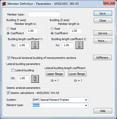

The Member Type Parameters dialog defines parameters of the member type for the American steel code ANSI / AISC 360-05. Access the parameter by clicking the New member type option in the Member Type dialog or by clicking the Parameters button in the Definitions dialog dialog. The following dialog displays:
The following parameters are defined in the dialog:
At the bottom of the dialog is the Seismic calculations - ANSI/AISC 360-05 option. After you select it, the software checks additional conditions to be satisfied by steel load-carrying elements subjected to seismic loads during the steel design. A set of regulations to comply with for seismic loads is based on the code ANS/AISC 341-05 - 'Seismic Provisions for Structural Steel buildings - Including Supplement No.1'. The check of steel elements of a seismically-loaded structure includes the verification of steel sections according to the previously-implemented American steel code ANSI/AISC 360-05 - 'Specification for Structural Steel Buildings' applying additional limitations given in ANS/AISC 341-05 - 'Seismic Provisions for Structural Steel Buildings'.
After you select Seismic calculations - ANSI/AISC 341-05, the following options become accessible:
If you select the STMF system, the additional option Special segment displays in the dialog; and if you select the OCBF system, the additional option is OCBF above Seismic Isolation Systems.
Note: The symbols included in the above dialog box are explained in the Results dialog box (the Detailed Results tab).The mentioned dialog box contains definitions of all parameters assumed in steel member calculations and result values obtained after member calculations.
Click the More button to access an additional dialog for definition of member type parameters specified in the code.
Click the Service button to open an additional dialog for definition of member type parameters (limit displacements, initial deflections).
Click Save to add the member type with the defined name and parameters to the list of previously defined steel member types.
