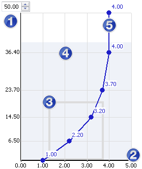

Wind Profile tab
Use the Wind Profile tab to create a variable wind profile.
Note: The wind loads created using a custom wind profile are tagged as "variable" in the list of loads, e.g. "Wind Simulation X+ 20m/s (variable)".
Wind profile: Graphic elements
To create a wind profile, click anywhere on the graphic curve to create a point, and then drag this point to the required coefficient.
  1. Height
    Allows you to adjust the wind profile curve, or to expand it beyond the virtual wind tunnel range.
    This option is useful if you want to save a wind profile in order to apply it to other buildings.
  2. Velocity factor
    The multiplying factor which refers to the velocity of the base wind.
  3. Building outline
    Shows a summary representation of the building size.
  4. Wind tunnel (light blue area)
    Graphic representation of the virtual wind tunnel.
    Note: The size of the virtual wind tunnel is set automatically, based on the size of the building. If the wind profile is bigger than the size of the wind tunnel, the simulation takes into account the wind loads in the inner limits of the wind tunnel only.
  5. Wind curve
    Curve representing a wind profile in a virtual wind tunnel.
Name
Enter a Name for the wind profile that you want to save.
Once saved, the profile name is added to the drop down list which allows you to select a saved profile.
<Load Wind Profile>
Contains the list of wind profiles if you created any.
Reset
Restores the default wind profile.
