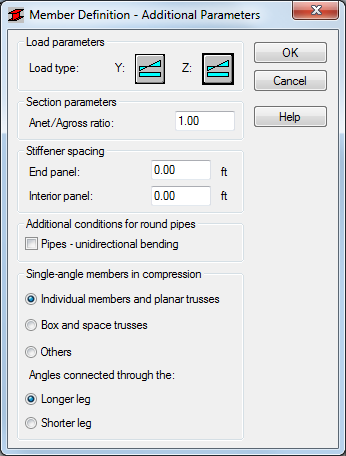

Use this option to define additional code parameters for the steel member type. Access the parameters by clicking the More button in the Member definition - parameters dialog.
The following parameters are defined:
- Load type for directions Y and Z.
- Section parameters
- Anet/Agross ratio. This value applies to a tensile force acting on the cable. It is a coefficient that defines the relationship of the member cross-section area, not considering the bolt or rivet openings (Anet), to the total cross-section area (Agross).
- Stiffener spacing for the outermost and intermediate panels.
- Round pipes case conditions. If the Unidirectional bending of pipes option is selected, then, for this type of section, a bending moment equal to a sum of moments operating along axis Y and Z is calculated; the resultant moment is the basis for bar design.
- Single-angle members in compression (see Section 13.3.3 of the code).
By selecting an option from this field you can define a function of single-angle members in a structure and how they are connected with gusset plates. Depending on a selected option, Robot calculates the equivalent slenderness of the element in compression according to Section 13.3.3. Thus calculated slenderness will be used for the buckling check for the directions Y and Z.
