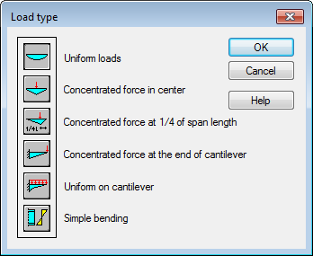

Load Type
Use this dialog to define the load pattern of the analyzed beam.
Access
Note: The SP16.13330.2011 code replaces the former SNiP II-23-81 version of the code for steel structures. Therefore, all references to tables or sections of the code apply to the SP16.13330.2011 code except otherwise stated.
Dialog elements
The information concerning the load type is applied in the calculation of the ψ coefficient value ( Tables Ж.1 and Ж.2), which in turn is used for the calculation of the lateral buckling coefficient according to Annex Ж.
Note: If you are using the SNiP II-23-81 version of the code, refer to the following sections of the code:
  • Tables 77 and 78
  • Appendix 7 point 1.
