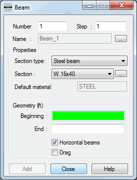

The following dialog displays then.
Use the fields at the top of the dialog to define a number and name of a beam. The Name field is not available for editing and displays a preview of the name created based on a selected syntax in the Names of Bars/Objects dialog box. By default, the syntax of a beam name is determined by the following variables: %t_%n and %t_%s, where:
%t - name of a bar type
%n - user-defined number for an object.
Click next to the Name field to open the Names of Bars/Objects dialog to define a new bar name syntax.
Below, you can define the following beam properties:
Note: You can define a new section by clicking next to the Section field.
At the bottom of the dialog box, you can specify more options for defining the geometry of a structure beam.
When Drag is selected, the end of the beam being defined is also the beginning of the next beam.
When Horizontal beams is selected, beams are defined in the XY plane; After defining the beginning point of a beam, the XY plane is set and the Z coordinate is defined for the beginning point. The end node of a beam must have exactly the same Z coordinate as the beginning node.
