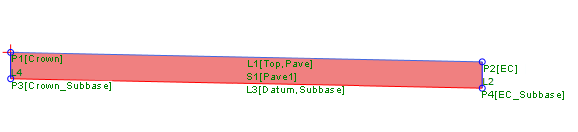

Use the Preview panel to see a graphical representation of the subassembly geometry as it is composed.
| To: | Do this: |
| Pan | Click the mouse wheel and drag. |
| Zoom | Scroll the mouse wheel. |
| Zoom to the subassembly extents | Click Fit to Screen. |
The Preview panel can display codes and comments that are assigned in the Properties palette.
| To View: | Do this: |
| Codes | Select the Codes box. |
| Comments | Select the Comments box. |
The Preview panel has two geometry preview modes:
If you assign a target parameter, the Preview panel displays its location relative to the origin point.
If a geometry element references a target parameter, drag the parameter to test how the subassembly reacts as the target changes.
