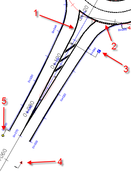

  2. Zoom in to the South To North Approach road.
    When you compare this approach road to the others, you see that, per the parameters you specified but did not apply to all the approach roads, these elements, which are shown in the following illustration, are different:
    1. The splitter island is not divided.
    2. The yield line is dashed.
    3. The J5 (keep right) sign has a leader line that extends outside the roundabout geometry.
    4. The A25 (approaching roundabout) sign is 60 meters from the circulatory road edge.
    5. The AB6 (exiting roundabout) sign is 50 meters from the circulatory road edge.
