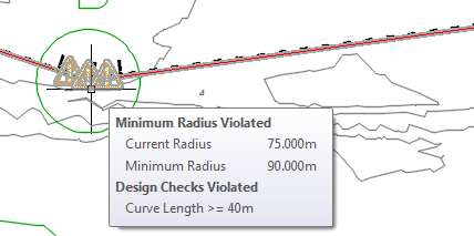

When a sub-element violates either a criteria or design check, a warning symbol is displayed on the sub-element in the drawing window, Alignment Elements vista, and Alignment Layout Parameters dialog box. When the cursor is hovered over a warning symbol in the drawing window, a tooltip displays information about the violation. If a design criteria has been violated, the tooltip displays the criteria that has been violated, as well as the minimum value required to meet the criteria. If a design check has been violated, the tooltip displays the name of the design check that has been violated.

  3. Hover the cursor over the middle symbol in Circle B.
    The tooltips are a convenient way to review design criteria violations in the drawing window. Two violations are displayed in the tooltip:
    • First, the curve does not meet the recommended minimum radius. The curve radius and minimum acceptable parameter values are both displayed.
    • Second, the curve violates a design check that has been applied to the alignment. Notice that the name of the design check is displayed, but not the current or recommended values. Values are not displayed because design checks are custom formulas that are created by the user.
