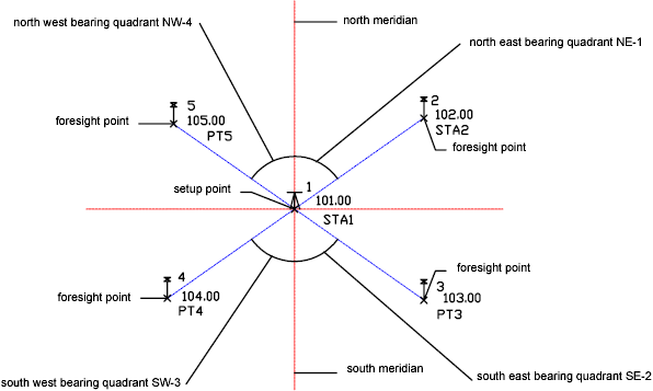

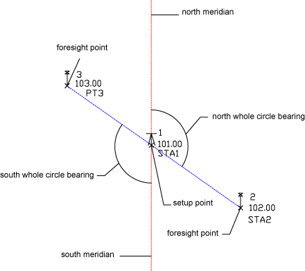

A clockwise angle measured from a reference meridian. Also known as north whole circle bearing. It can range from 0 to 360 degrees. A negative whole circle bearing is converted to a clockwise value.

An angle measured from North or South, whichever is nearest, with the added designation of East or West. The angle is always less than 90 degrees (IP/2 radians or 100 grads) and is referenced by a quadrant number.
