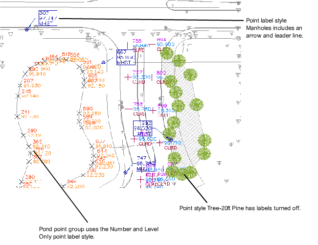

Displaying and Labeling Points
To control the appearance of a point symbol in a drawing, either select a default point symbol, or create a point symbol.
Examples of point label styles
You can automatically label points with predefined labeling criteria as you create points in a drawing.
