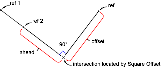

    AutoCAD Civil 3D determines the offset distance of the point (entered in step 5) from the line established by the first two points. This establishes one known side distance and two known side directions. Using this information, AutoCAD Civil 3D calculates the corners of a square and creates the corner of the square offset from the line (established in steps 3 and 4) at the same distance as defined by the point entered in step 5.

The Square Offset command lists the ahead distance and offset distance to the intersection point.
Command Syntax
SQ [reference 1] [reference 2] [reference]
Parameter Definition
reference 1 The existing end point on the vector. It can be any type of point, including a figure point.
reference 2 The existing start point on the vector. Ref 1 and Ref 2 establish a direction on the vector.
reference The point off the vector. The intersection point creates a right angle between the vector and this point.
