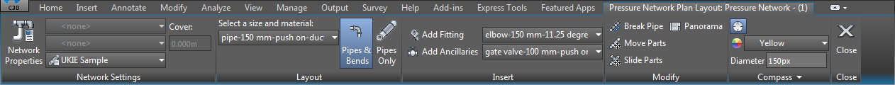

Use the Pressure Network Plan Layout ribbon to create and edit pressure networks in plan view.
To access the Pressure Network Plan Layout ribbon, do one of the following:
On the Home tab, click Create Design panel Pipe NetworkPressure Network Creation ToolsFind. When you run this command, you are prompted to enter information into the Create Pressure Pipe Network dialog box. After you click OK in that dialog box, the Pressure Network Plan Layout ribbon appears.
Select a pressure network. The Pressure Networks contextual ribbon tab is displayed. On the Modify panel, click Edit NetworkPlan Layout ToolsFind.
The following commands are available on the Network Settings panel:
Reference Alignment: Specifies the reference alignment, which provides chainage and offset information for the pressure network.
Pressure Network Parts List: Specifies the pressure network parts list, which contains the parts that are available during layout. The available parts in the parts list also impact the display of the compass. For example, if a parts list contains only a 90 degree bend, the compass shows 90 degree angle increments.
Cover: Sets the top of the pressure network at a specified depth below (or above if the value is negative) the reference surface during layout.
The following commands are available on the Layout panel:
Pipes & Bends: Creates pressure network pipe segments in plan view and inserts bends at directional changes. When creating a pressure network, the Pipes & Bends option is selected by default. Select the size and material of the pressure pipes to insert from the Select A Size And Material list.
Note: When you use the Pipes & Bends option, the pipes and bends share the same material and nominal diameter.
Pipes Only: Creates pressure network pipe segments in plan view and inserts deflected pipes at directional changes. Select the size and material of the pressure pipes to insert from the Select A Size And Material list.
The following commands are available on the Insert panel:
Add Fitting: Adds a fitting to a pressure network in plan view. Select the type, size, and material of the part to add from the drop-down list.
Add Ancillaries: Adds ancillaries to a pressure network in plan view. Select the type, size, and material of the part to add from the drop-down list.
The following commands are available on the Modify panel:
Break Pipe: Breaks a pressure pipe into two pressure pipes at a selected point. The pressure pipes are connected, and are contained in the same network as the original pressure pipe.
Move Parts: Repositions selected pressure network parts to a new location in the drawing.
Slide Parts: Moves a group of parts along another pressure pipe.
Panorama: Opens the pressure network Panorama, which you can use to view and edit pressure network properties.
The following commands are available on the Compass panel:
Compass Visibility: Controls the display of the compass in plan view.
Compass Color: Specifies the color of the compass.
Compass Size: Specifies the diameter of the compass in pixels.
Compass 3D Plane: Specifies the increment by which the working plane is rotated in model view. When you are working in model view and the compass is visible, you can use the following keyboard shortcuts to control the compass plane:
Enter P to rotate the compass plane in increments equal to the value of the increment setting.
Enter Shift+P to rotate the compass in the reverse direction.
Enter R to restore the compass to the initial plane setting.
Compass 3D Snap: Specifies the increment by which fittings and ancillaries can be rotated in model view using the compass. This increment setting applies to the compass when invoked with the Rotation grip on fittings and ancillaries in model view. When you are working in model view, you can click the Rotation grip to activate the grip and the compass.
