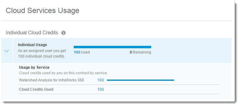

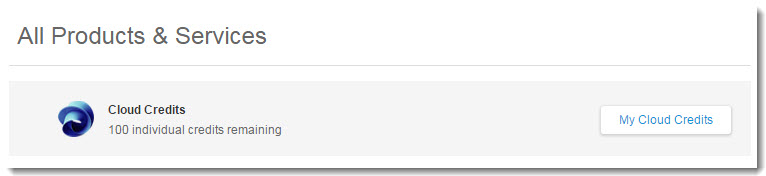

How can I tell how many cloud credits I have?
You can find your cloud credit balance at manage.autodesk.com. The top of the All Products and Services page will show your individual cloud credit balance.
Click My Cloud Credits to see additional cloud services usage information. You can click on a category, such as Individual Cloud Credits or Shared Cloud Credits (if available), to see more information. Click Individual Usage to see your cloud credit usage for each individual cloud service.
