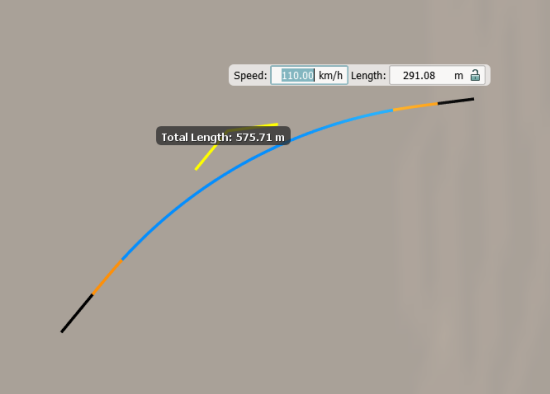

    You can set the design speed of the road as you draw it.
  5. Click to add curves.
    A curve is automatically created at the intersection point. For design roads, the default curve geometry is determined by the design speed of the road. To edit curves, see About Editing Horizontal Road Geometry.
