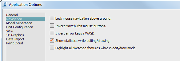

To set navigation options
  1. Click .
  2. In the Application Options box, click Navigation. Select options to activate them.
    • Lock Mouse Navigation Above Ground prevents underground views from appearing.
    • Invert Move/Orbit Mouse Buttons reverses the functions of these buttons within InfraWorks 360.
    • Invert Arrow Keys/WASD reverses the behaviour of letter keys w, a, s d and arrow keys for navigation.
      Keys Option checkbox cleared Option checkbox selected
      an and d move left and right pan left and right
      w and s tilt up and down move forward and backward
      up and down arrow keys move forward and backward tilt up and down
      left and right arrow keys pan left and right move left and right
    • Toggle display of statistics such as total length or volume of an object while you edit and draw.
    • Highlight sketched features when you're in drawing mode.
