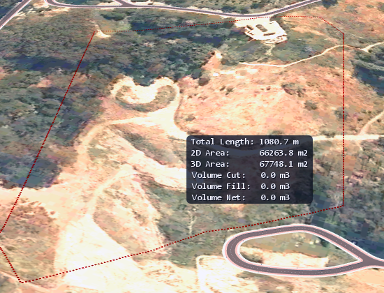

The Terrain Statistics tool measures total length, 2D & 3D area, as well as volume of a selected terrain area.
The measurement information appears over the perimeter.
Volume information appears only if you adjusted the level of the measured area, for example, by adding a coverage and adjusting its height.
The tool is still active and you can measure another area.
