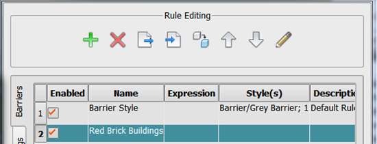

- In the Style Rules Panel, click the tab for the desired feature class to style. The tabs are on the left side of the Style Rules panel. For example, to create a rule for buildings, click the Buildings tab.
- Click
to create a new style rule. When prompted, enter a name for this style rule, for example, "Red Brick Buildings." After clicking OK, the new style name appears in the Rule Editing window.
- Select the new style rule and click
or double-click it to open the Rule Editor. Optionally, enter a description for the style.
